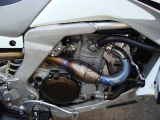

What exactly are you looking for? My megabomb will be here this week and as soon as i get my new intake setup I ill have it dynoed. I personally have liked fmf since my 2 stroke days but I am the only person on this forum running an fmf! As soon as I get that done I'll post dyno sheets. Also My setup won"t be just a full exhaust but also the Hot Cams stage 2 kx dirt bike cams. Oh yeah and a pciii and custom tune. Call fmf they are really helpfull.

I love it! It's a little loud with the power core muffler so with a dasa or two brothers I think it would be annoying. Otherwise the torque is there and plenty of overrev. Also I think it might take some fabrication to fit. I used exhaust tube from auto zone and silicone but it works fine with no leaks.

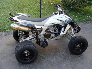

yeah they said it would to, quiet it down, but it is definitely louder at WOT. I think it is subdued alittle like not as harsh or pingy sounding as the slip on alone. But my neighbors will agree that the raucous has went up a few decibles. A friend of mine is putting one on a dasa. I'll post pics when that is done.
