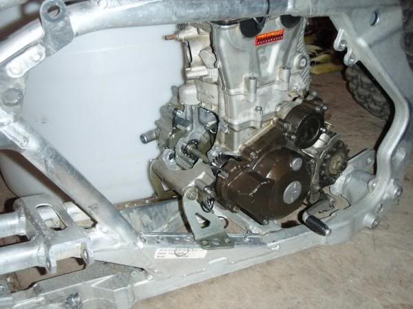

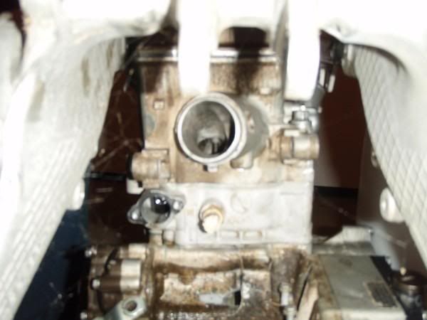

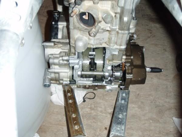

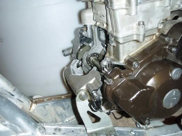

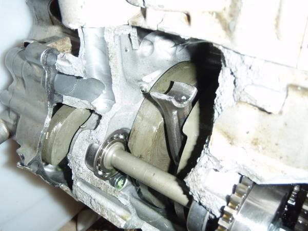

I had just come back with my friend from riding all day. And me and my buddy went in to grab a water and i left my bike idling. While in the house i herd my bike die. So i went to go shut off the key and coolant, oil and everything else was all over my driveway. motor was fully built and had at least 100+ hours on it. it had josh creamer for 07 then it got me halfway though the 08 season. best part is it took the whole motor. everything. smashed tranny shafts, gears clutch, all the cases starter. didnt ruin the head

the cranks on the kawis are only able to handle 10-14 hrs with a high compression piston. Josh creamers factory mechanic told me that. i prob should have listened :p
Yes you should have, his mechanic (dave therrien) is also my mechanic, ive posted on here before about that too, its a well known problem, im surprized you lasted as long as you have. Josh can go through motors like you just did like crazy, especially if he doesnt change the crank at 10 hours
