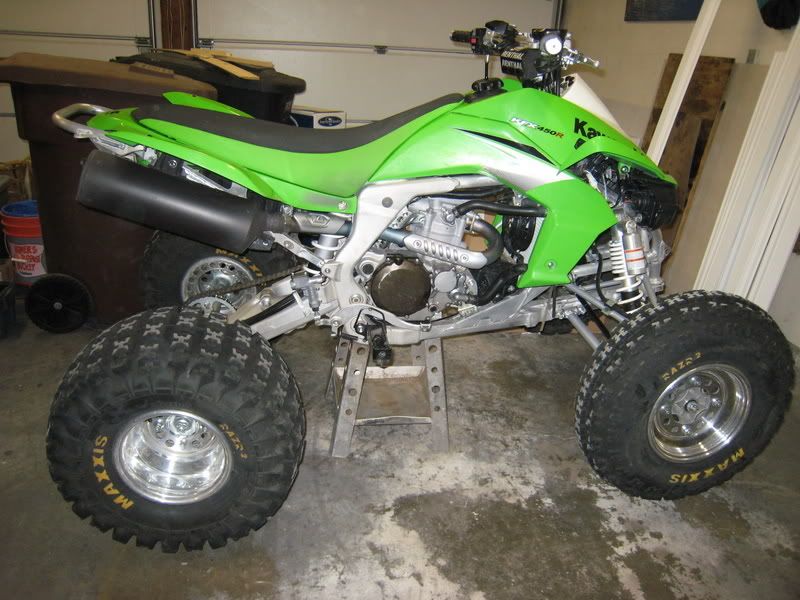

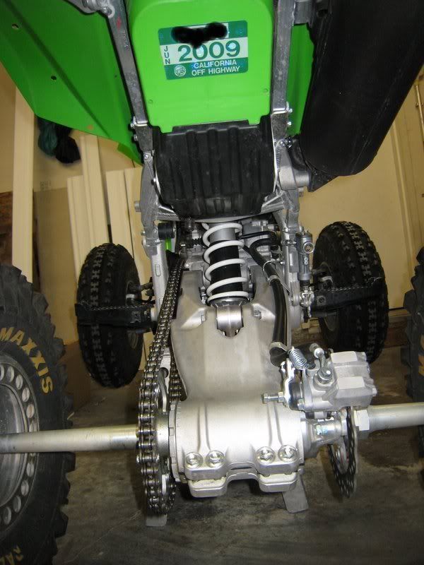

Lift up the quad so the rear suspension is at full droop

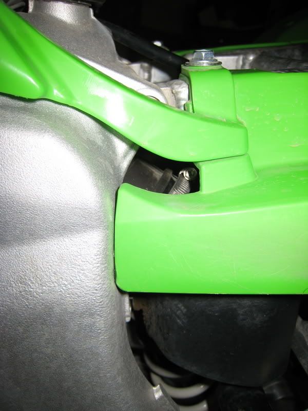

Looking at the shock at full droop from underneath

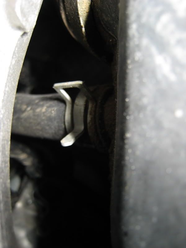

You can get to one of the hose clamps here

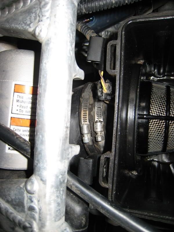

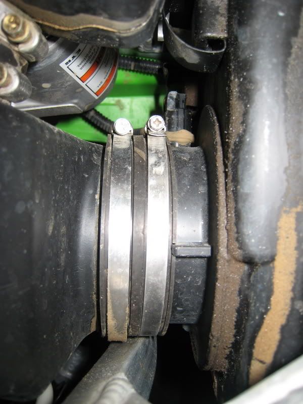

Looking down on the stock intake. You can see the two hose clamps that hold on the larger intake tube and the air temperature sensor mounted on the old air box

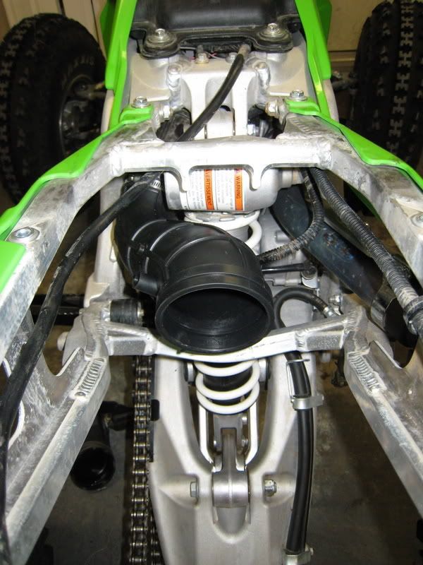

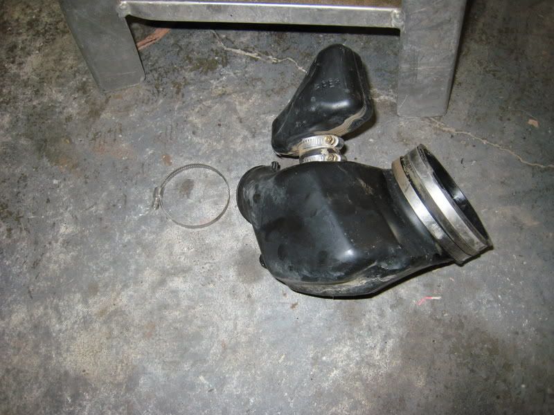

The stock larger intake tube. Fuel is right, this thing is VERY RESTRICTIVE

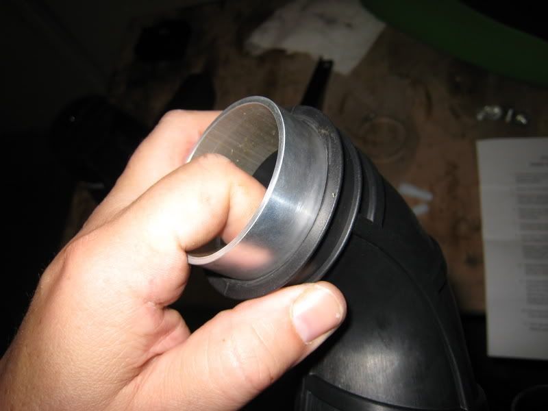

Mounting the billet adapter into the new intake tube. It is a tight fit, but if you put a couple fingers on the inside of the tube and push the intake tube over the billet adapter, it will slide together without too much problem
