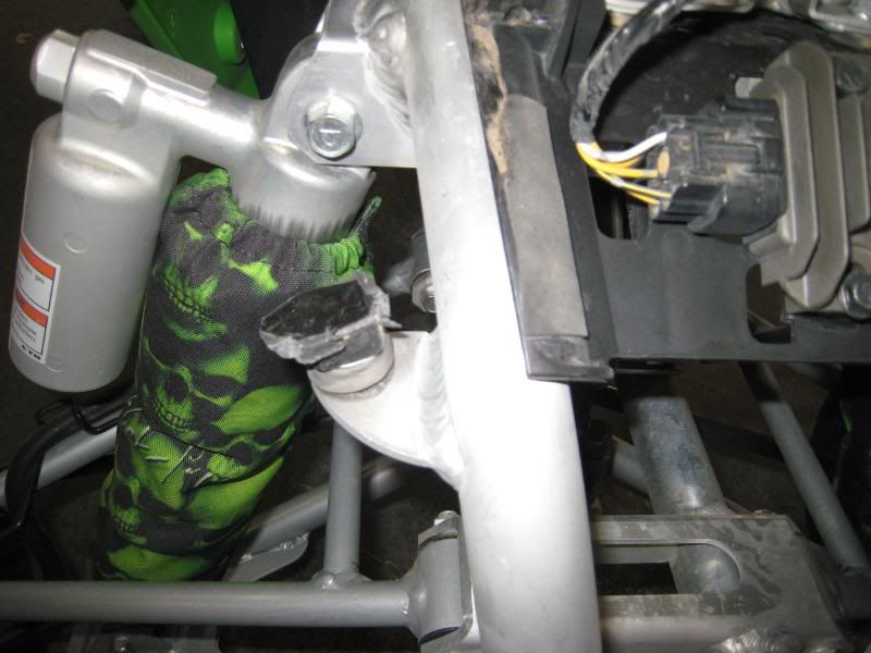

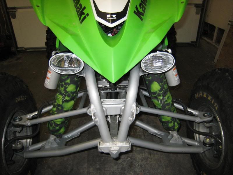

I ordered up a stock lighting harness, so I would not have to cut any factory wires. I soldered and double shrink wrapped the wires for the HID lights. They bolted up to the stock mounting tabs. I have one spot and one flood. Both are 6000k and are very bright.

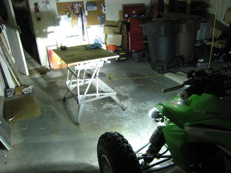

Well the HID's worked great. They were very bright and I had 0 problems thru the weekend with them. I even crashed (yes again) and they are still functioning fine.
The light they put out is incredible! Sitting next to another quad running halogen lights .... it is just so hard to compare. Actually they don't compare at all. I have one flood and one spot both using 6,000k bulbs and they are wicked!
